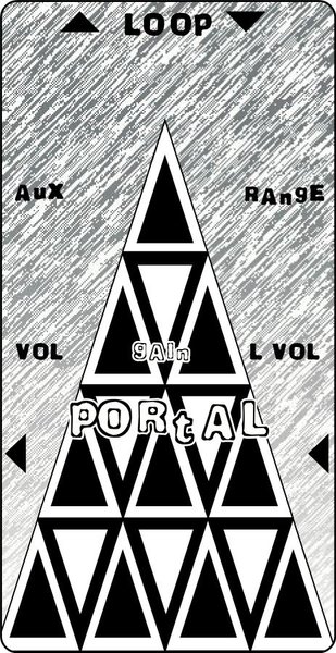

Re: molecule inspired fx loop
did the artwork today, just waiting to finnish the pcb, to label the knobs

Re: molecule inspired fx loop (Portal)
Here's a sneak, this will be available under another brand (kinda like a side project). That i need to get a domain, and create a website
