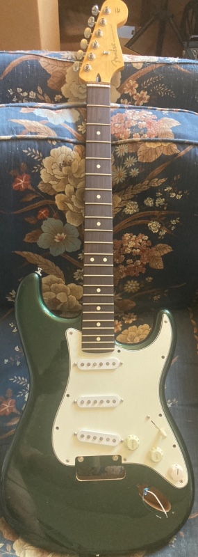

i got the pickups in, which was simple, and installed the Tonestyler which was not. the wiring in the Strat didn’t match the wiring diagram, because the positions of the tone pots was reversed. after puzzling it over for awhile i finally decided to just rewire it to match the diagram. so far, so good. but i can’t test it yet because the soldering iron battery ran out before i could connect the jack and the ground wire to the tremolo claw. when the battery’s live it’ll only take a few minutes to solder 3 wires. then i’ll tap-test the pickups to see if everything’s properly connected, and then string it up. assuming everything’s kosher i’ll move on to the bridge adjustments. i want it done by tomorrow night because i’m taking the as-yet-unaltered Supro and the Wandré to Charlie’s house so he can check them out…he says he’s been tempted by both but hadn’t gotten to play them, and i know the Tonestyler is going to blow his mind. it seems possible from here. i’ll see how it goes.
you can see here how much better the covers for the CS69 pickups match the pickguard. unfortunately the Tonestyler doesn’t work with Strat knobs because its shaft is D-shaped and requires set-screw knobs. i chucked a white MXR knob on there for now and it’s not awful, but i prefer matching knobs. there don’t seem to be set-screw Strat knobs available other than metal ones in various anodized colors that look weird. maybe i’ll paint some metal ones with the Vintage White nitro i got for the Jetstar. or maybe i’ll take the easy route and just get more MXR knobs. i’ll probably do another pass on the Jetstar before i switch over to the M-77T because i’m tired of these long-term unfinished projects.

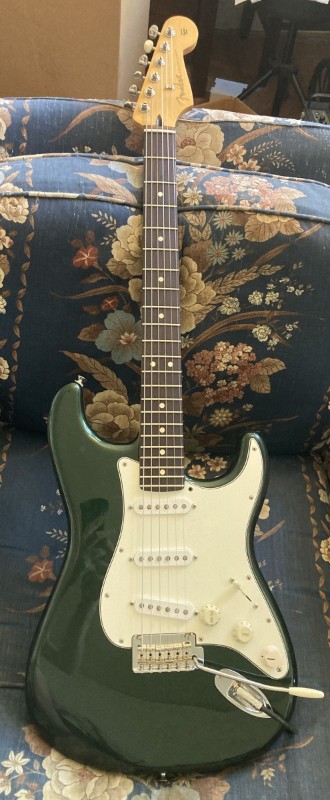

it's done other than final adjustments to truss rod/string height/tremolo springs to get things just as i like them. the Tonestyler is just as good as i remember it being; it's particularly nice that i can make the CS69 pickups sound like the CS 54 pickups in my sunburst Strat by using the first active position (the first two positions are true bypass and simulated load of a wide-open pot). it's much more versatile than a varitone, with only the most capacitor-ized position of the eight being too muffled to use.

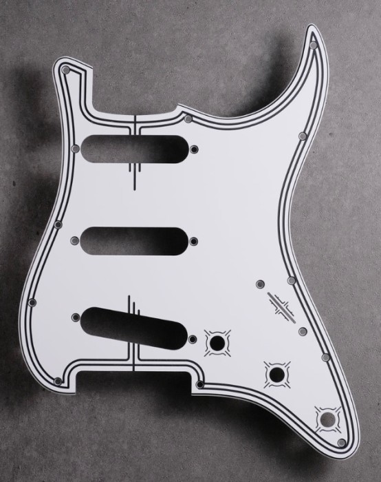

i decided to get a Decoboom pickguard for the Strat. the plain white guard is kind of boring with the deep green. unfortunately the back plate is out of stock so that’ll have to wait. i think this should work well.
