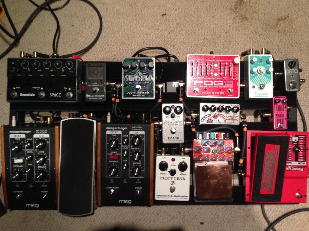

Here is what I am currently putting together. I've got my live board all set up, but I wanted to put together a studio board for recording.
This is another biamp rig with my signal being split into two chains and going into two different amps.
Right now I have a Linear Power Booster that I built up with dual mono outputs feeding the two chains.
The guitar chain (for the time being) goes: Montreal Assembly Wrong Side of Uranus, SSBS Mini + Hawk, HOF Mini (currently loaded with Sigur Ros TonePrint), Bukowski Harmonic Perc, Way Huge Fat Sandwich.
Bass chain is currently: Verellen Big Spider, DIY 4 knob RAT, Tall Font Sovtek, 6 band EQ.
There are a few things that I would like to do to this board.
I'm going to be adding in a Soda Mieser to the bass chain, right after the RAT but before the Muff. I also would like to build up a Madbean Lowrider and put that after the Big Spider in the bass chain.
I also want to swap the LPB for an ABY switch, and put the LPB pre ABY just so I can have a boost on board for different pickups.
I'm thinking I might get a true bypass strip sized enclosure to put the ABY in and for the time being leave the rest of the enclosure undrilled, and add as necessary. It might be handy/helpful to include two bypass loops after the ABY, one for A and one for B so that I can mute the chain at any moment if I want to. This way too I could have the outputs to amps from the loop strip and not from each chain. Just a convenience thing. I could move the whole board up where the empty space is in the back and be able to put the strip up front.
I think I'll also end up putting the DL4 at the end of the chain to have both signals passing through as well for looping.
Other than that, I haven't really had any time to play around with this board in the exact formation that it is in, BUT each chain has formations/orders of pedals that I have used in recordings/previous board setups that I've enjoyed so I figure it should work out pretty well.
